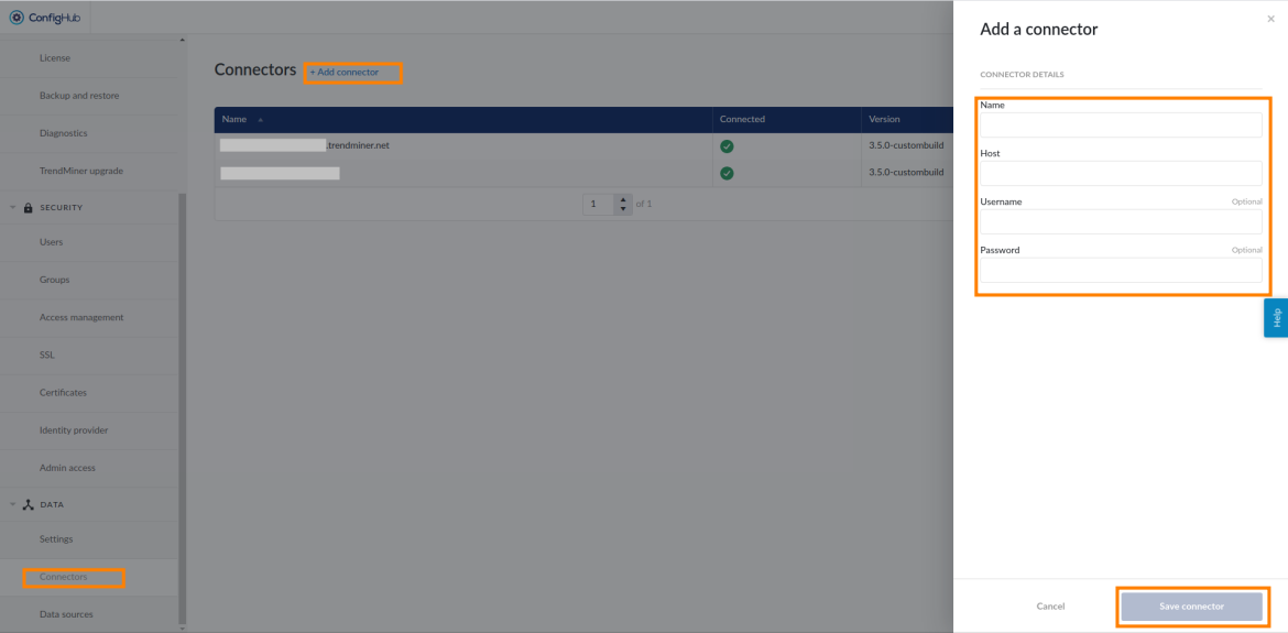

As soon as these are working properly, enter the connector details in ConfigHub. Authentication is optional and only necessary if the set-up requires it. Only Basic Authentication is supported.

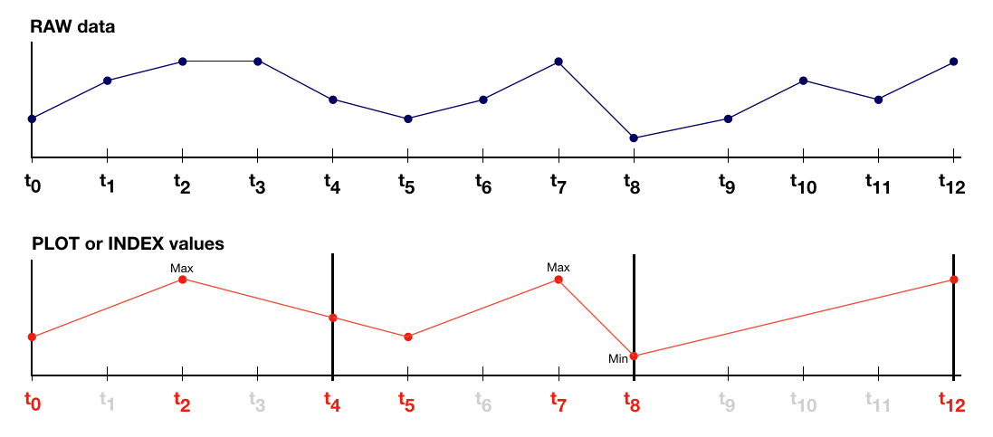

2.1. Principles
When the OnlySupportsRawValues flag is set to false, both the /api/v2/tags/indexvalues/ and /api/v2/tags/plotvalues/ endpoints need to implement the exact same logic as described here.
Each request will include a numberOfIntervals query parameter.
The requested time period should be divided in this number of equal-length intervals.
For each interval, the response should include at most 4 data points.
first value within each interval
last value within each interval
minimum value within an interval, if lower than first/last
maximum value within an interval, if higher than first/last
Intervals that do not contain data at all do not result in data points in the response. Intervals that contain less than 4 data points, result in only as many data points as they contain.
Data points at the edges of the requested time period should also be returned or interpolated.
2.2. Example
Here is a simplified example for the call startDate=t0&endDate=t12&numberOfIntervals=3:
The response in this example would be:

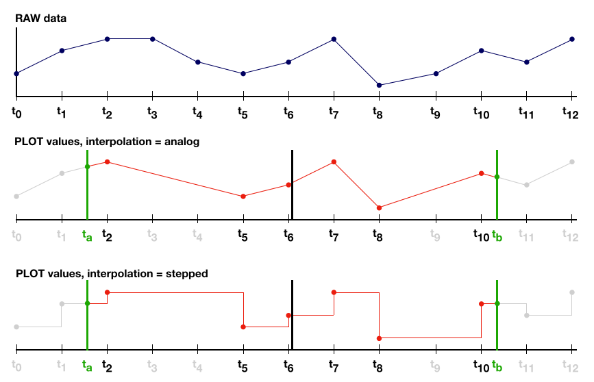

2.3. Between Values & Interpolation
In the real world it is rare to see such a coincidence as in the previous example where the startDate , the endDate , and all the intervals fall exactly on values within the raw data.
In the example below we’ve used the same raw data but requested a startDate=ta and endDate=tb that fall in between raw values in the archive.
Even the divide between two intervals does not fall in line with a specific value.
The response in this case looks like this:
| interval 1 | interval 2 | |
first value |
t2 |
t7 |
last value |
t6 |
t10 |
min |
t5 |
t8 |
max |
On the edges of a plotvalues call, TrendMiner also expects to get the exact values on the startDate and the endDate, respectively according to the type of interpolation.
This in order to create a complete view in the graphical representation (trend).
In this case both ta and tb 's values have to be added to the response array.
Retrieving the analog value for ta and tb can be done through linear interpolation.
For example:
\$Vta = Vt1 + (((ta-t1) * (Vt2-Vt1)) / (t2-t1))\$
Since t1 and t11 may not be known in each data source, one possible solution could be to add another interval before and after and respectively use their lastValue (for t1) and firstValue (for t11).
